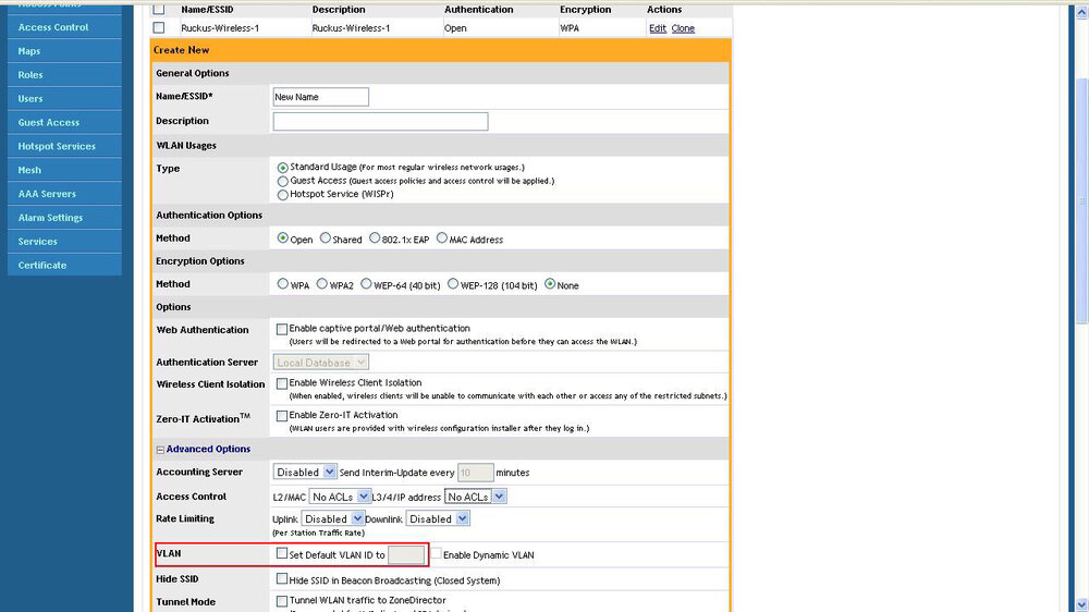

Sorry guys - one last question: If we decide to go ahead with this, and create two VLANs (one on the 10.56.75.0 - VLAN1, with VLAN2 on the existing 10.56.80.0 interface), how would we then go about tagging the relevant wireless box port on the switch?
I.E: Our Wireless box will need to be configured as follows:
Staff wireless: VLAN2 - 10.56.80.0
Guest wireless: VLAN1 - 10.56.75.0
So what configuration would be required on the switch? Am I correct in thinking that a port on a switch can be configured with multiple VLANS?
Thanks,
Rhys
If your switch is layer 3, yes. Do you have a wireless controller? What vlan will the AP's management IP be on?
You will need to create 2 ssid's and assign then to the vlans
On the switch you wound untag on the management vlan and tag the ssid vlans
Also, its a bad idea to have a guest access with no isolation. If the guest wireless is not isolated from the rest of the network (acls etc) and only given bare minimum access (internet only) it could be used to attack your network with very little accountability
Ok - thanks for your help.
The main IP of the wireless box would be on the existing 255.255.248.0 network, with a two VLANs configured - one for Staff and one for Guest. Would this work OK?
Thanks,
Rhys
Edited by rhys1984
So the staff wireless will be the same ip range and vlan as the main network as well as the management interface of your ap's, and the guest wireless will be on a different vlan/ip range? If so on the switch port connected to the ap, untag the staff vlan (this should pass through to the default ssid) and then tag the guest vlan and link it to the guest ssid.
