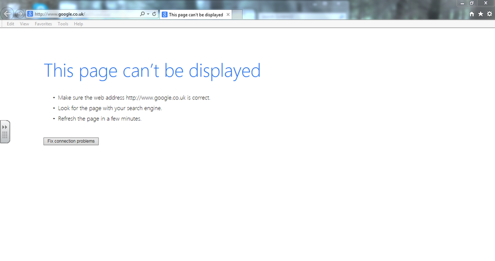

Sorry should of also added some machines will connect but will say Unidentified Network and can't do anything such as access the internet or contact the servers.

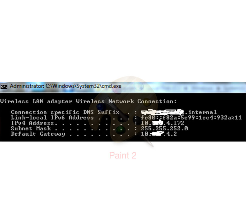

On a troublesome wireless machine, what IP info are you actually getting? How does this correspond to what you think should be set?

The ones with limited connectivity... what IP do they get? Is it the 169.254 (or summat) addresses?
