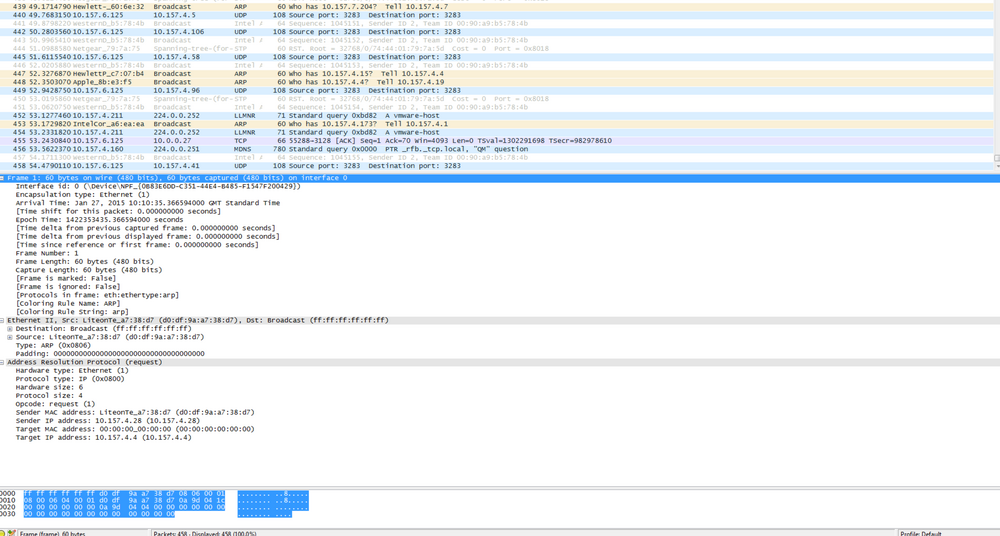

Have you fired up Wireshark - what type of traffic is actually creating the most packets in the list - where is it coming from?

I'll give Wireshark a go and see what it tells me, though I've never used the software.
Wireshark won't load it just brings up something called Xterminal?
Im guessing this is Mac OS? You will need XQuartz to run Wireshark, and then it can take up to 10 minutes on first run to load.
I downloaded Quartz and it has been far longer than 10 minutes :/

Grab Wireshark portable if you are having trouble and open it on a PC (probably much easier if you have a windows machine to hand). It runs out of a folder but does need to install one thing. Capture your (wired might be best to start with) nic traffic and ask about the type of packets you're seeing most. If there are lots and lots of broadcast 'whose got x please tell y' then we're starting to narrow things down a bit. Is x or y nearly always the same address? Narrowing down further...

The wireshark screen grab you posted suggested a reasonable amount of UDP 3283 traffic which I had to look up... Port 3283 (tcp/udp) :: SpeedGuide Are you using Apple remote desktop heavily?
I'm afraid this is one of those issues that often takes a while to pin point the culprit.
