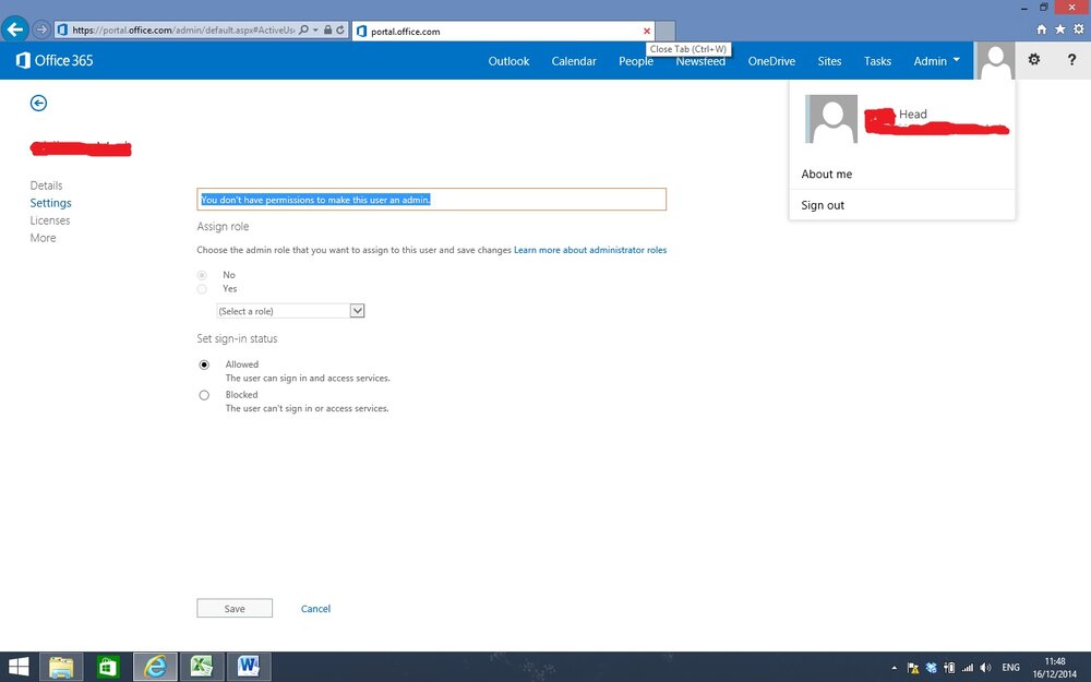

Well when I see this:
Use distribution lists in Exchange to manage email distribution. Set up distribution lists and other Exchange groups in the Exchange admin center.
and I click on it... I get:
403
Sorry! Access denied :(
The page may not be available or you might not have permission to open the page. Please contact your administrator for the required credentials. For new credentials to take effect, you have to close this window and log on again.
So I'm guessing you would have to contact BTLS??
(I was logged in with the itcoord address)
Yeah I get the same thing, I do remember it working a few weeks ago though - they must have clamped down on permissions a bit too hard.

You can edit groups if you own them by using the admin menu > Exchange then groups but when you come to add a person it just hangs on the screen where you select the person. I managed to add to a group using the power shell command but that's all I have managed to do so far. I'm not getting anywhere else with other commands which I assume is a permission issue ie if I do get-mailbox it only returns my mailbox and not all of them or other commands cannot find recipients or the switch on the command I am using. I'm guessing you need to be a global admin for these and these accounts are just user admins which is understandable for a lot of school setups.
I think that will be the issue. Maybe send them a request with exactly what you want them to do? The guys on the desk are normally quite helpful (for me anyway ;) ) hahah!
Okay I have had a few things done for me by them today, it was a permission issue that was stopping me and they say the "team" are looking at expanding current permissions for the admin accounts.

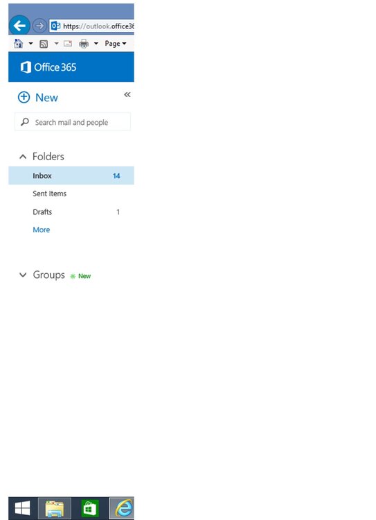

Also quick note about distribution lists:-
When in outlook click (the person in the top right)
Options >
Under mail go down to distribution lists>
Then click distribution groups I own (if the ITcoord created these)
And you’ll see them all. Clicking on admin > Office 365 > Groups and Set up distribution lists and other Exchange groups in the Exchange admin center does not work.
@ChrisH
Options >
