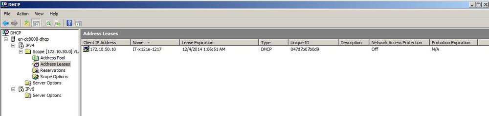

Funny fact is also that the DHCP Server actualy thinks it give out and lease to the client???
But it never recieves it?

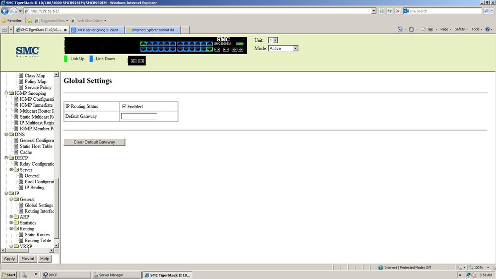

Well that doesnt make much sence... Because i can ping from one vlan to another?
And the web interface even say its enabled?

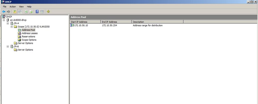

I have a Scope on my DHCP server that is 172.10.50.x/24

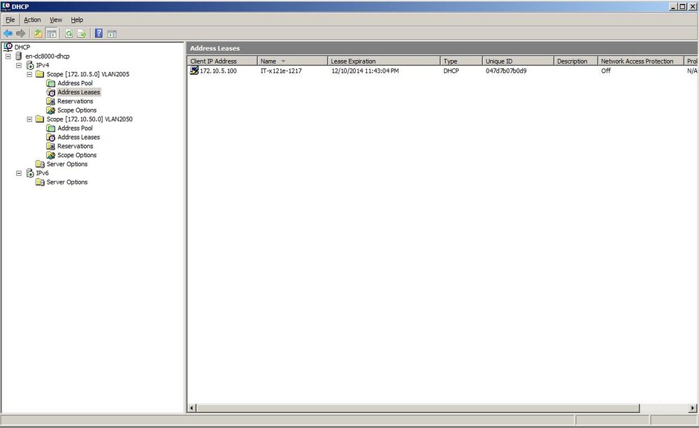

I did find something odd, i tried to add a new Scope to the DHCP Server.
And know its trying to give the IP adresse from that scope to the client, but still client doesnt recieve it.
But it seems to be related to that vlan is not tagged correctly then? It should be givin a IP from VLAN 2050 instead.
