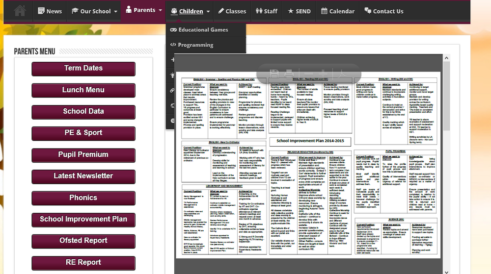

You have issues with your menu and embedded PDF's See attached.
[ATTACH=CONFIG]27086[/ATTACH]

Good advice thank you. The menu and embedded PDF's seem to be fine on my end. Is anyone else having the same problem as FN-GM ?
It doesn't happen in chrome but does in Internet Explorer 11.
Why is it always Internet Explorer 11 I have issues with! No worries I will look into it thank you. I am hoping we have everything Ofsted requires and I am now looking to keep on improving the children's section so they start using the website at home more.

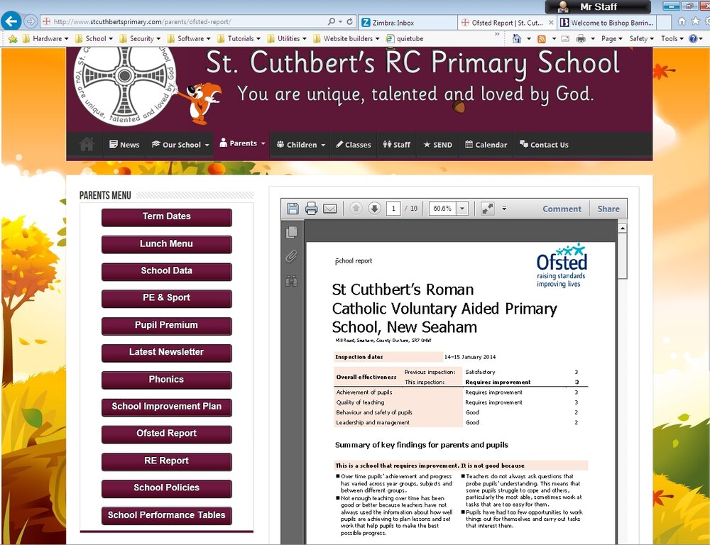

@bazgee:
I don't have any problems with it using IE11 :)
[ATTACH=CONFIG]27096[/ATTACH]
@FN-GM (Should have gone to specsavers hehe!) ;)
Maybe you should have done! You don't have a menu open, so it won't happen! :D :D
Z-Index on the menu's needs to be higher

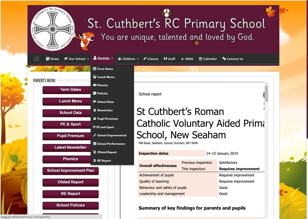

Hows this?
[ATTACH=CONFIG]27103[/ATTACH]
Does this qualify? hehe! ;)
You have chopped out the browser window. I bet your using chrome really? :p :D
Ooh! your really hard to please @FN-GM :(
It really is IE11!
But I had you going for a minute ;)
PDF reader plugin is not embedded within the page it seems thats all :)
