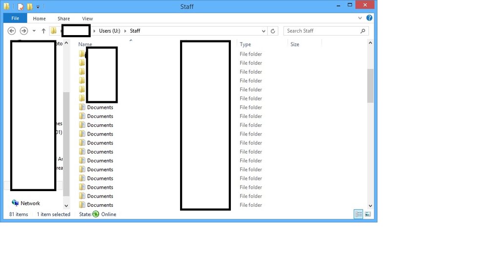

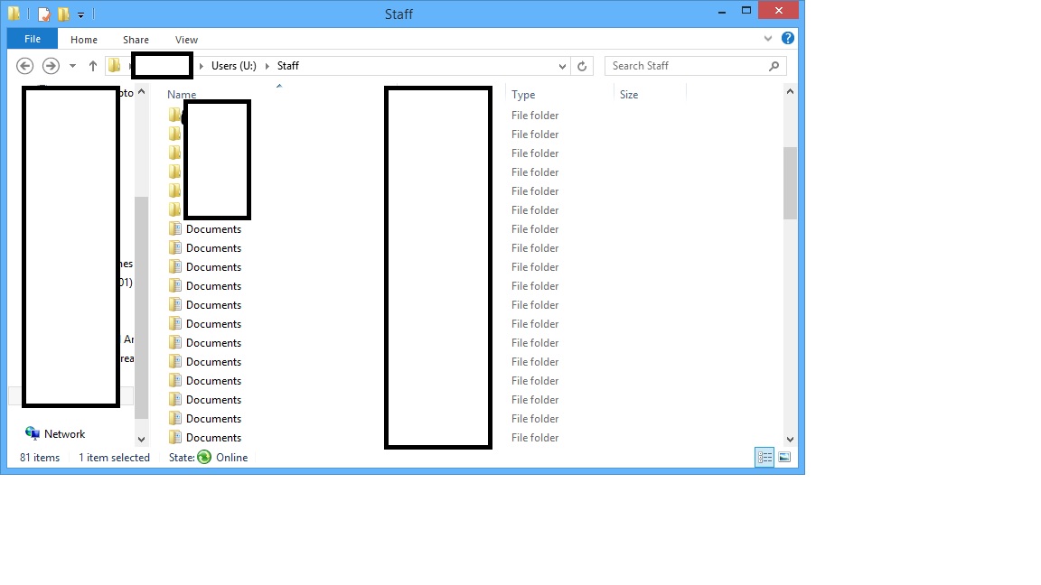

Since going to Windows 7 everyone's Home Directory has that annoying desktop.ini which changes the folder name to "Documents". Hard when staff are trying to find a users drive.
I've set a GP option to disable it (does sod all), I've emptied the file and turned all the security off so it's totally inaccessible, but it still happens.

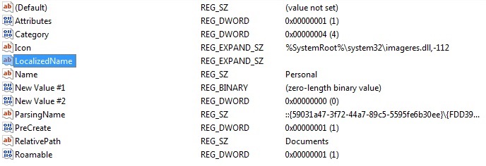

Run this REG at startup in your GPO, as this'll cure the problem.
Windows Registry Editor Version 5.00
; Prevents User folders being renamed to Documents after logging on
[HKEY_LOCAL_MACHINE\SOFTWARE\Microsoft\Windows\CurrentVersion\Explorer\FolderDescriptions\{FDD39AD0-238F-46AF-ADB4-6C85480369C7}]
"LocalizedName"=hex(2):00,00
