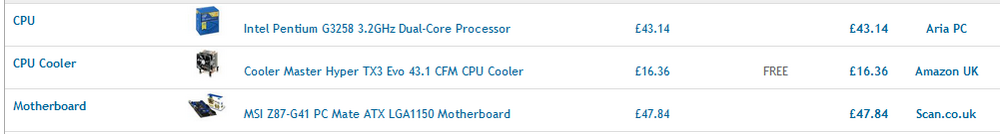

So I'd say, from some clicking around on PC Parts Picker:
[ATTACH=CONFIG]26277[/ATTACH]
Assuming you don't need to buy a Windows licence.
DVD/RW, RAM, case, HDD are all interchangeable, they were just cheapest in the list. Motherboard is a fairly random pick as well, stick to Asus/Gigabyte/MSI IMHO. PSU, Corsair are a reliable brand - I don't know anything about EVGA as a PSU brand. Look for reviews before you buy any PSU though, especially if you can find a jonnyguru review.
Can't really squeeze an SSD in at the moment, but it's an easy upgrade in the future - Corsair MX100 256GB are about £75 at the moment, which is a right royal bargain. 256GB will outperform 128GB and gives you a bit more breathing space, though with a 1TB HDD alongside you shouldn't have any problems. Set Steam to install to the mechanical storage, games don't get much benefit, and having to manage your library is a PITA.
My tuppence, anyway!
EDIT: saying that, I forgot to factor in the Pentium G3258. If you don't mind overclocking - and it's pretty damned easy with an Intel K chip - get the 20th Anniversary edition Pentium, a cheap Z87 board and a decent cooler and get top-drawer single thread performance at 4.5GHz (or thereabouts). Works out about the same price as the 6300 + mobo, but should perform much better in games. Only 2-core/2-thread, but it gives you ample here-and-now performance.
Link to new build, the top now looks like this (and if anyone can genuinely recommend a cooler, as I have no idea atm, that'd be grand).
Edited by sonofsanta
