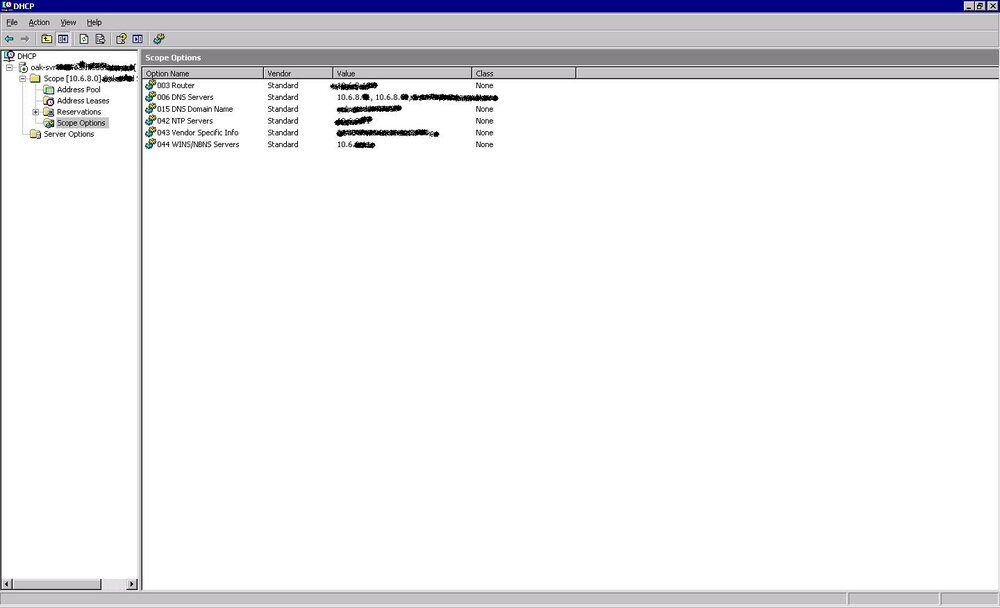

Hold the phone... Has he set the DNS servers in DHCP options too?
under ipconfig /all does it say the DHCP server is the servers IP address?
If so login go to Administrative Tools/DHCP and set the DHCP options for DNS server to the Domain controllers IP's.
