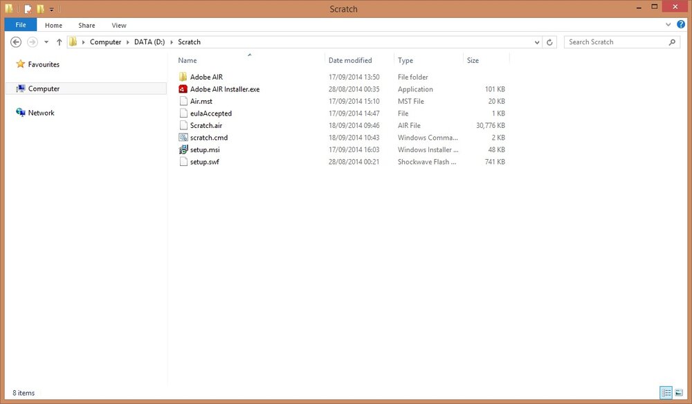

In the end I had to do a command line install from startup script, using the *Linux* .air Scratch download!
Used a few bits from other posts in this thread.

Using the Air MSI and a transform to remove autoupdate and copy the eula accepted file in (one on this thread didn't work, perhaps because I didn't have the file, but there is a nice guide on how to do it all with orca).
Edit Added mst for Air v15 and eulaaccepted that goes in the folder with the Air msi.
Note: With the script I have the install.cmd file in with the setup.msi and the scratch.air in one folder (hence the %~dp0 to get the script folder)

I have a single folder called scratch, with the cmd file, the contents of the AdobeAIRInstaller.exe *extracted* with 7-zip (so you have a setup.msi some other files and a Adobe AIR folder) the eulaAccepted and the Scratch.air.
If you already have an Air version installed that uses a different path for install then you need to change the paths for the install check.

pic
