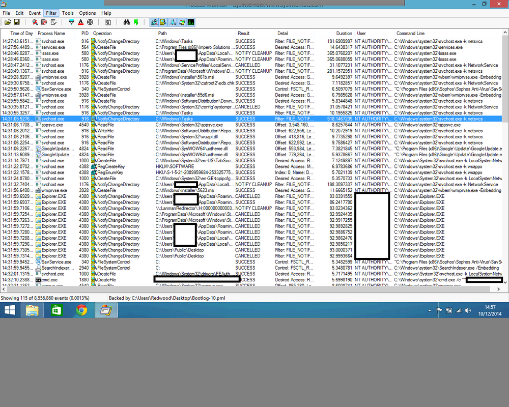

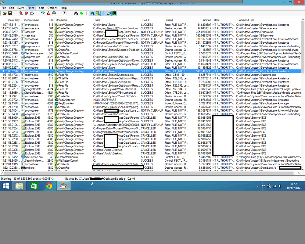

Heres a log of when a user logged in (removed names).
Isass.exe takes 365 twice and svchost takes 518
