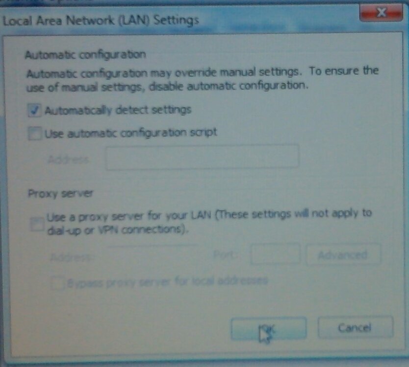

I have got a old dell laptop that i have been asked to look at because it will not connect to the internet. I opened up Command Prompt to see if i was getting a outside connection, so i pinged BBC - Homepage and got a reply. Sounds odd to me. I then looked in internet options and clicked on connections tab, on the LAN settings it has got nothing ticked but all input boxes are white like they are active. (See image) IE Settings01.JPG

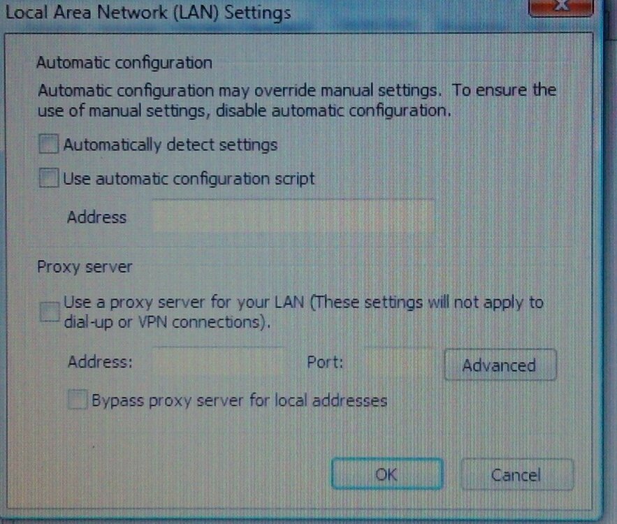

If i then Click on the "Automatically Detect settings" tick box and tick then untick the proxy server box it looks like it should be. With everything grayed out other then "Automatically detect Settings" But when i go to click on the OK button it doesn't do anything. Almost like it have got a setting wrong but its the same as every other computer have i. (See Image) IE Settings02.JPG
Has anyone seen this before? Hope this makes sense.

In the registry if you right click on the Internet Settings Directory and go to permissions, might be worth while checking against a working machine what the permissions are meant to be and ensure that the permissions are set correctly
Wondering if the system or relevant groups have the wrong persmissions and when you try and alter the proxy settings via GPO or manually etc it may be sending the relevant commands to update this registry key however due to the permissions being wrong it may be failing to actually change the relevant sub registry keys within the Internet Settings directory
