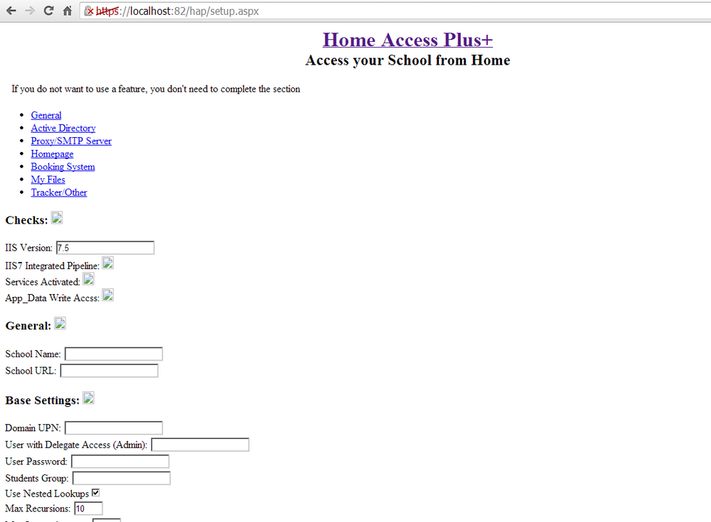

Well, HAP is being a right PITA to set up...
Created a self-signed cert and added to server to stop it moaning, and still didn't stop the problem. But, I found out that I needed to remove the following:
Dunno why didn't like it on server, but now it shows correctly.
Then, I found out that I needed to add permission to the registry log to allow it to read the event log
Then, I now find it moaning with the users mappings... Folder is there, all is fine, but it moans that something is wrong, and it's logged in the error log. BUt I can't find anything in error log?!
So annoying this!!! Grrrrrrrr
[ATTACH=CONFIG]20398[/ATTACH]
The something is wrong error message means that Local Logon rights aren't set up on the server
