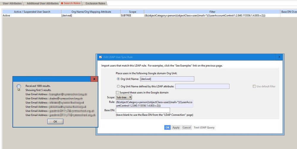

I’ve checked and I then set it to 90% and did a simulation but the same result. It did not detect disabled AD accounts and so did not say it was going to suspend any google accounts.

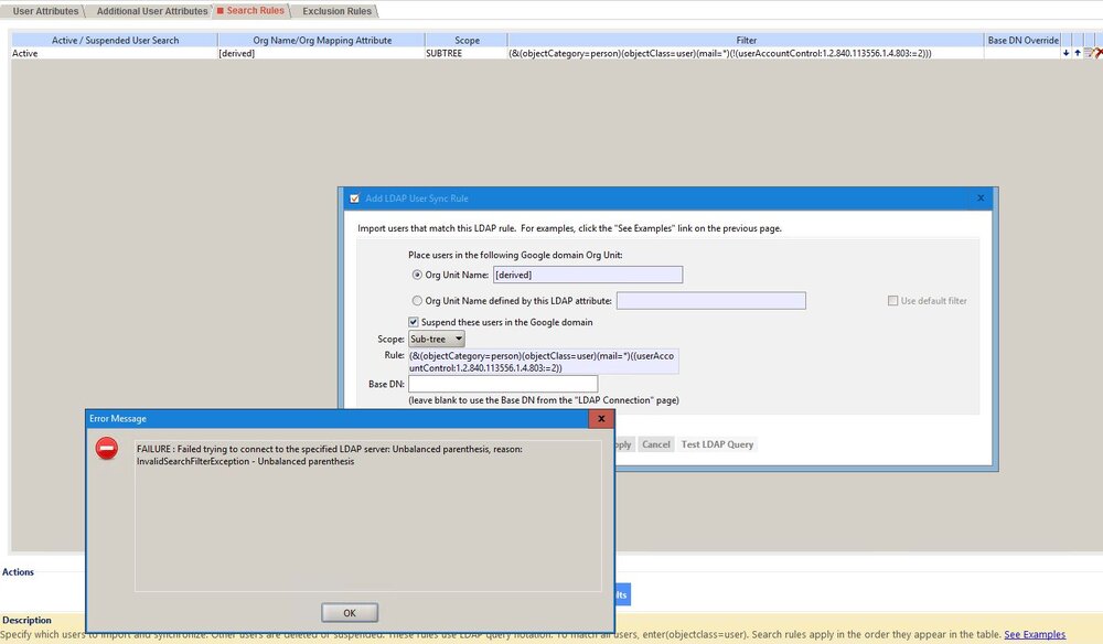

I don't know what's going on! I have tried putting in a second rule with the same syntax you had and with one less bracket but I get the "unbalanced Parenthesis" error I posted earlier. If I put in the extra bracket then there is no error but gives 0 results.
So the existing filter has always had the extra bracket ) at the end and has always been like that. If i put in the expression the same as yours without the extra bracket then I get the syntax error as in my previous screenshot. It just doesnt make sense to me that it seems to work for you but not for me! With the extra bracket I get results returned.
That's strange because when I use the same syntax as your screenshot I get an error. If I add in another close bracket at the end then the syntax is accepted but when testing it returns 0 users.

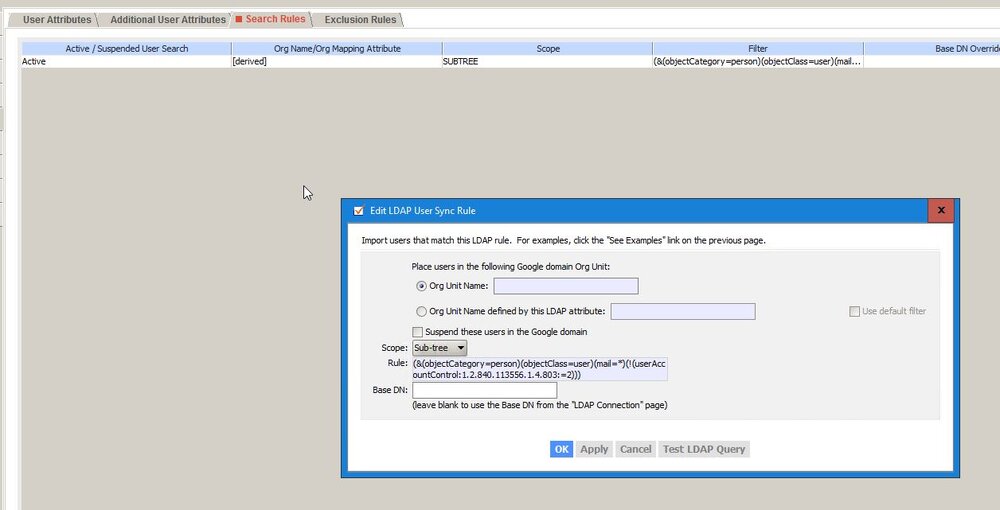

We have been using Google Cloud Directory Sync since 2015 and it has always worked really well. It always only looked at active users in Active Directory and any that were disabled in AD would then get suspended in Google. Recently any disabled used in AD no longer get suspended in Google. Below is the rule we have in place. The rule matches what Google say will return only active users from AD. https://support.google.com/a/answer/6126589#zippy=%2Cspecific-ldap-queries All active (not disabled) users that have email addresses in Active Directory(&(objectCategory=person)(objectClass=user)(mail=*)(!(userAccountControl:1.2.840.113556.1.4.803:=2))) Any pointers would be most welcome.
