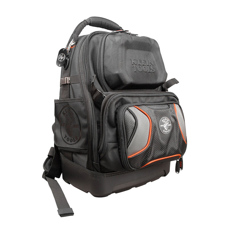

I have one of these... Product link it's a bit heavy but has survived a few years of abuse, though I swapped the insert out for my old Stanley Fatmax insert as it laid out my screwdrivers better.
