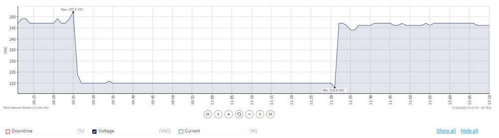

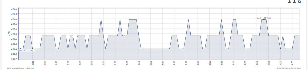

It is still worth getting electricians in to explain the situation? Is it something they need to rectify or nothing wrong with these alerts etc? We have fixed wire testing every 5 years but guess they don't pick up on things like this?
3 phase Substation on the school's site! all underground
I have several APC UPSs on site. During the normal week/working day I get no alerts of the UPS compensating for high input voltage. However, evenings and weekends I get several alerts. Other than turning off the email alert for this particular alert - is there anything else I need to look at which is causing this?
