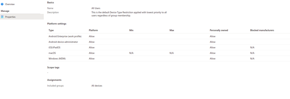

AH, In this portal https://intuneeducation.portal.azure.com/ I now found a tick box in Tenant setting. clicked it. now gone back to Endpoint Manager> Devices> Enrol Devices> Enrolment Restrictions> Device Type Restrictions as you have said. I can now edit the settings. Thanks
Just done a couple of tests with a couple of virtual machines. Signing into Teamsn and "allow my origination to manage my device” creates an device entry in endpoint,microsoft.com. The OS is Bit Lockered and the key saved to desktop. The key does not show against the device. If i go into Bit locker and click "backup your recovery key" click " save to your cloud domain account" it immediately saves and is viewable against the device in endpoint. The same as i saw against the parents device. So now thinking the parent has done the same. ie the signing in with a O365 account will not automatically grab the Bit Locker key. Its just that they have save to the key to the domain account. Cheers
Hope you can help. We do not use MS InTune (as yet). Had a email from a parent asking why we are managing his laptop with InTune. The device has never been attached to my wireless. This device is totally a personal device. So far as I understand it, they had downloaded the MS Teams app, then signed in with the daughter’s office 365 account. Apparently they are having trouble signing out of Teams. On his investigations the laptop is registered and managed by our InTune. Also Intune has a copy of his BitLocker recovery key. Checking my Azure AD and drilling down to the devices I can see that a copy of the BitLocker recovery keys are there. I am guessing that when they have signed into the Teams App they have left the tick in the box “allow my origination to manage my device” If they did leave the tick in the box, there is no warning about what info they would give (ie the Bit Locker key) Quite rightly the father is not happy about the fact I now have his bit locker recovery key. Is there a way to stop the grabbing of the recovery key? What have I done wrong, all the setting are out of the box. Any pointer greatly appreciated Cheers
