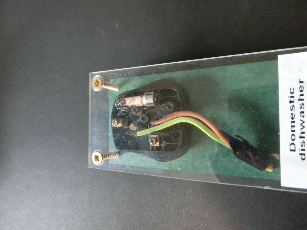

If you look at the image you can see that if PE is disconnected, the case can rise to a non zero voltage, which can be significant. Cy capacitors. Example image, but conveys the gist.
Ummm... Outer insulation strilled WAY to far back, clamp on the inners, well it would have been if both screws were still there. Live terminal not tight enough so had over heated, further loosening the terminal, resulting in the plug melting. Earth terminal loose, and as you say, wire too short. Once the earth is removed, the filtering capacitors raised the shell of the machine to 1/2 live voltage.

Before I married Mrs_C, her dishwasher bit me. Not a full 240V shock, but a good tingle. So I looked at the plug.... It is now used in "How to wire a plug" lessons, and H&S "Why do we PAT?" sessions.
