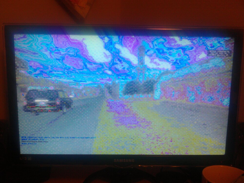

Update. @mac_shinobi sent me a very useful thread on GPU repair guides (https://forums.ebuyer.com/showthread.php/73485-*Graphics-card-failure-repair-guide*). I thought that if my card really was on the way out, then I had nothing to loose so gave it a go. So I stripped the GPU down to it's bare bones, gave it a deep clean, a dab of thermal paste etc and stuck it all back together. Got the card back in yesterday and played a few solid hours of ARMAII: Wastelands. No crashes or lock ups at all. Looking good so far! I'm happy as I don't have to splash out a wad of cash on a new GPU. On the flip side, I'm slightly gutted that it is working as I could do with (well, I want) a newer GPU! However, Saved cash > new GPU. I'll be gaming over the W/E and really test it and update with the results...

So, my faithful, and rather old Nvidia GTX280 GPU looks like it's finally on the way out after years of service. After 30 mins to an an hour of game time, my rig locks up and this happens: Due to a number of things suddenly breaking, funds are now tight at the moment so I can't afford to splash out on some top end GPU. Therefore any recommendations on a low/mid range GPU are most welcome. Edit: Budget: £100-£150 (May try and stretch to £200 if it's a good deal, and if I can convince the Mrs!) Games: Currently playing: BF4, DayZ SA, DayZ, ARMA3, Skyrim etc Brand: Always had Nvidia cards from Asus, but willing to consider all options... including AMD. Rig specs in my sig so something that will complement it.
