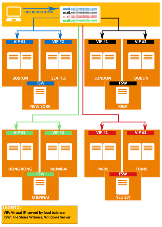

I'm only talking site failures in the above. When Three of your Four Exchange servers are up you should have no issues with failover.
Ideally the FSW would be in a third site. That way it's available in a site failure situation to provide Quorum for either Site. If that's not possible, you'd be looking at one site that was able to activate if the other went down, and one which would require manual activation if the site with the FSW went down.
You'd either want an extra server in each site, and extend the opposing sites DAG to it, or to go down to one DAG and have all the mailbox DBs in a single one across all servers. Neither of these will give you full automatic failover without having the FSW in a third site. Attached is my setup, each region is setup like that.
So, what you have here would survive a server failure, but not a site failure. Normally, including FSW, you'd weant an odd number of votes in a DAG group. So when a member is missing more than half the total votes remain, meaning a cluster election can be won. More here: https://practical365.com/exchange-server/exchange-2016-database-availability-groups/ However it occurs to me I thought you could only have 1 FSW per DAG (not counting the alternate FSW setting, which doesn't work like you'd think). So do you actually have 2 DAGs here, with one exchange server in each?
Well, there's a lot to consider here. Which exchange version? How is the namespacing setup between the servers? When you say "a fileshare witness on that site" is that a single or two FSW? Either way achieving quorum with that could be a manual process. Ideally, a two member DAG would have a FSW at a tertiary site. That way a single site failure could be survivable (as 2 votes are available for DB activation out of 3 total).
