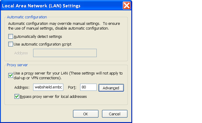

I've tried installing Google Chrome as well, that won't connect either and brings up a message saying it can't reach the proxy server. Now, we have just changed over the proxy server in the East Midlands, but the settings are correct with the new details and the all the other PCs in the building work fine - including an identical machine next to it.

The proxy settings are definitely there - they are pulled through from Group Policy. I'll double check the Automatically Detect Settings box when I'm next at that PC.

Have checked the Automatically Detect Settings box and that is unticked.
