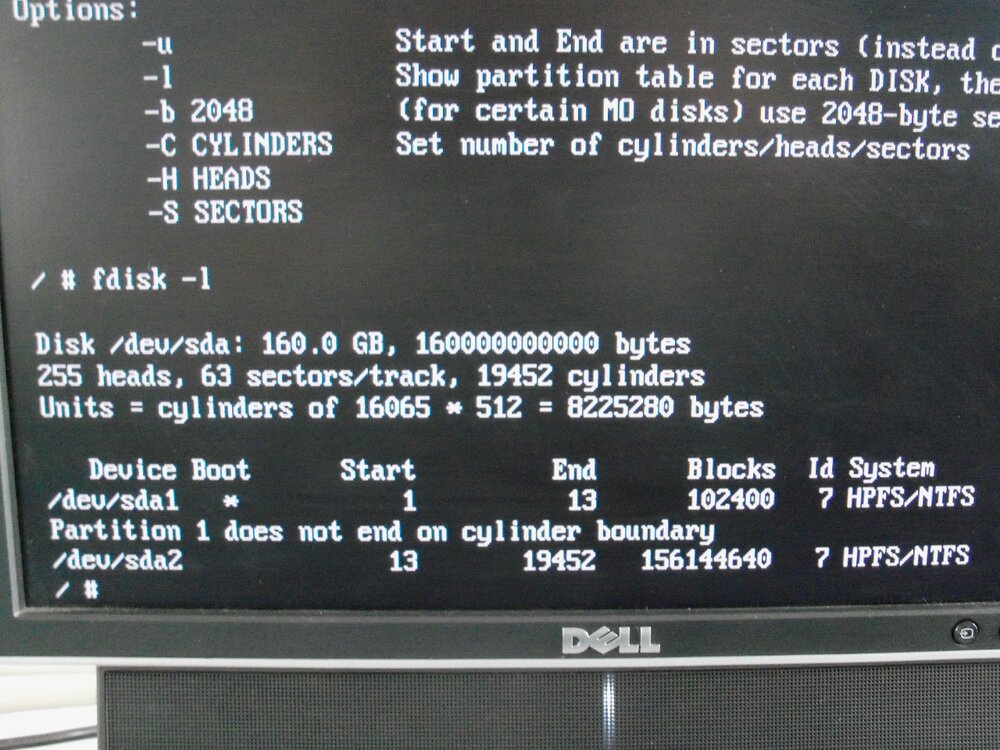

If this workstation is new it may default to using EFI boot and the Windows installation may partition the disk using GPT instead of MBR. That could cause problems, you can check in the disk management MMC snap-in in Windows. Also try booting FOG into debug mode and list the partition layout with fdisk -l. Run this before and after imaging to see if partition table stays consistent. If you are using GPT partitions then fdisk can't work.
It is possible to install Windows 7 from the install media and not have the separate 100MB partition. This might be worth a go if you run out of other things to try.
Had a big rush job on so not had time to do any further testing the profile but running fdisk -l seems to give an error.
So it looks like the hidden partition is stuffed :eek:
This is the disk info after imaging DC7900 after (2).JPG As you can see the end of sda2 is 1 cylinder more than before imaging.
I've taken another image this time with fog set to multiple partition single disk and that works fine on the desktops so just sending that to a different type of DC7900 to check that works.

Well the image works with the other type of DC7900 so I'm happy with that. While I was playing with fog I reinstalled win7 deleting the partitions and letting win7 create a new one. Fdisk listed the partitions as shown in the first screenshot. I took an image using single partition single disk but when reimaging the client wouldn't boot and gave the same error as before so it looks like I must use the multiple partition option.
