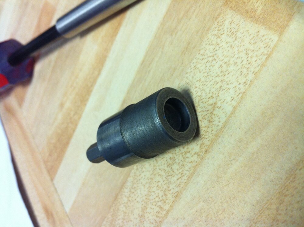

Disaster Posted November 18, 2011 Author Report Posted November 18, 2011 [ATTACH=CONFIG]12158[/ATTACH] That? Steve yes that's it i'm sure! You know the name or where I can get one?

Hawkeyez Posted November 18, 2011 Report Posted November 18, 2011 They are an odd thing, they are magnetic, and dont seem to offer much grip on the "nut" (which in our case is rounded edge flat head) I have a feeling, the few that we had that used this, have since been replaced. If you have to luck today, I will have alook around the rooms (80 odd), and see if we still need the bit.

Hawkeyez Posted November 18, 2011 Report Posted November 18, 2011 Having looked at ours, you will find that the fit isnt actually circular, just slight oval.
Disaster Posted November 18, 2011 Author Report Posted November 18, 2011 ahh, that'll explain why it can unscrew the locking nut. I thought it was magic or something up until now!

HodgeHi Posted November 18, 2011 Report Posted November 18, 2011 Could you not dremel a line across the nut and then use a standard screwdriver? I had to do that to remove the bracket from one of our projectors since it needed to be mounted onto a new one.
Hawkeyez Posted November 18, 2011 Report Posted November 18, 2011 Could you not dremel a line across the nut and then use a standard screwdriver? I had to do that to remove the bracket from one of our projectors since it needed to be mounted onto a new one. Good idea!
Disaster Posted November 18, 2011 Author Report Posted November 18, 2011 Good idea cheers. Looks like it is an OVAL PAN HEAD SECURITY TOOL. Just got to measure up to make sure
