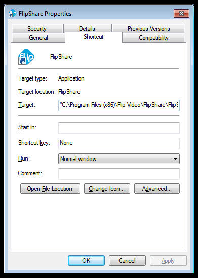

This would mean two sets of icons for the same software in the Start Menu/Desktop. However I have noticed that some shortcuts are '32 Bit/64 Bit neutral' [the same icon can be used on 32 Bit or 64 Bit OS]
Office 2010 has this type of shortcut.
http://gyazo.com/5f94b2b3963ddefa8c41bd0934ea7051.png
http://gyazo.com/d66ed036fe62db1fe5b0c541b7ebc991.png
Whereas the FlipShare shortcut specifies in the 'Target' box C:\Program Files (x86)\...
I would like to be able to deploy icons like these for more of my software. Is it possible?
