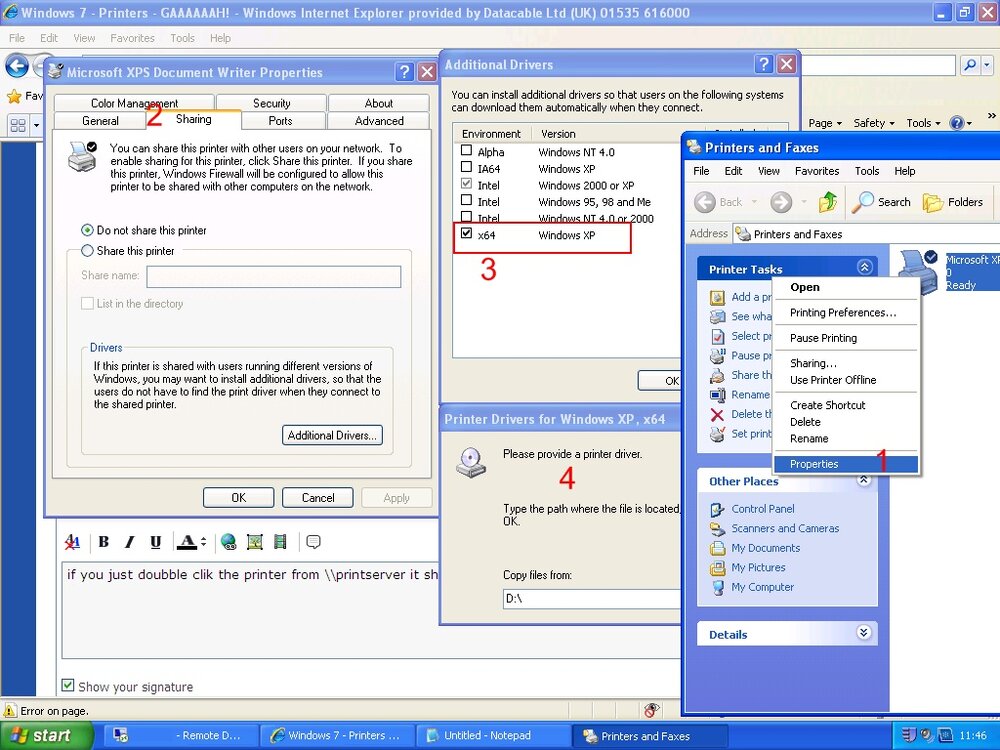

try and connect the printer up to a win7 box directly via usb see if it prints then If so connect the network printer (go to \print server and double click it) assuming it adds it you should then be able to go to the sharing tab and add x64 drivers from the workstation to the server
How do you get the drivers off the workstation into the server? - I've tried pointing the server to the files listed on the test page but it insists they're no good :(
if you just doubble clik the printer from \\printserver it should add it then just add the aditional drivers from the sharing tab hopefully it should realise they are installed and just copy them if not they should be in the spool dir i believe
Look at your testpage that you printed and it lists all of the files that the printer driver is using, copy them all up to the server in a folder and try pointing it at that.

Sussed it- here's some GREAT advice- the drivers need installing on the Print server via a 32-bit machine. Connect to the networked printer as Admin, go to the additional drivers and check the x86 box from there and it installs them on the server. YES!!
