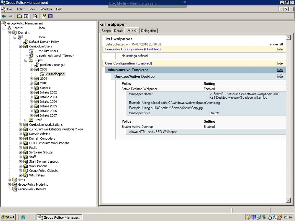

No thats a server 2008/windows7 problem. I run server 2003 at the moment. Done all the research!
@sidewinder seriously considering bginfo, despite everything working brilliantly on xp clients we will be having more windows 7 clients before we upgrade to server 2008 so this background thing is really bugging me now! Do you use bginfo with success on server 2003/windows 7? If so any chance of a walkthrough?

Seriously cheesed off with backgrounds now! Tried bginfo a few years ago and didn't have much success with it. So in desperation and sheer determination to make the ********* background work, I'm thinking of not using server 2003 group policy to set backgrounds but to put a registry setting to set background for current user in a logon script, with the background stored on the computer. Is this feasible?
