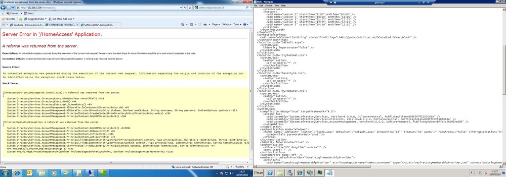

I've now managed to complete the configuration but am recieving the following error when trying to connect. It looks like a bind error but all of my ldap values are correct (i think).
Do i have to add the ldap port aswell?
cheers
If it's standard AD and you haven't fiddled you don't need an LDAP port.
Have you set the "aduser" and "adpassword" OK?
Might be nothing/irrelevant, but is that a space between DC=cadcol and the subsequent comma?
You are correct, it's a LDAP issue.
Is yoda.cadcol.ac.uk the primary domain controller's FQDN??
You could also try LDAP://DC=cadcol,DC=ac,DC=uk
