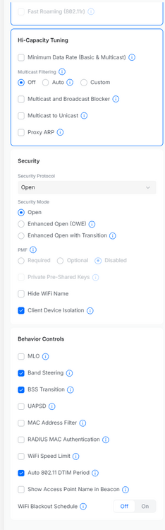

I don't think any of these settings would be related but just in case our unifi guest network settings are as follows:

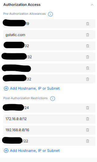

And the hotspot settings - pre auth allowances in place for the controller IP, core switch IP, smoothwall IP and the guest network IP range as well as gstatic.com which I recall being important but shouldn't be related to your issue.
Post auth restrictions are the usual array of internet networks and a couple of our internal ranges not related to guest wifi.
