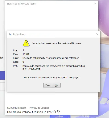

We're having issues with SSO for our student users/devices. We are a hybrid setup, devices + users are managed in AD & then synced into Entra. Sophos firewall, Windows 10 22H2 devices using the ESU licence
Upon a first login to a machine, SSO does not work 90% of the time. When this behaviour occurs, the user cannot manually sign in to Teams, OneDrive or Edge, they present authentication and/or scripting errors. Logging out and back in again sometimes fixes it. Below is an example of one of the script errors when trying to log in manually to Teams.

I've checked firewall logs to make sure nothing Microsoft related is being blocked, I've checked HTTPS inspection to make sure we aren't decrypting content to/from Microsoft domains as I've read this can cause issues too. In event viewer, the following error codes are present under AAD: 1104, 1160, 1085, 1081, 1025.

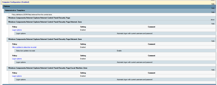

have you added the policies required? Seems like your missing quite a few.
you need the below and trusted urls etc...
hide
https (Order: 1)hide
Generalhide
Action
Update
Properties
Hive
HKEY_LOCAL_MACHINE
Key path
SOFTWARE\Policies\Microsoft\Windows\CurrentVersion\Internet Settings\ZoneMap\Domains\autologon.microsoftazuread-sso.com
Value name
https
Value type
REG_DWORD
Value data
0x1 (1)
  • Like 1
hide
Generalhide
Action
Update
Properties
Hive
HKEY_LOCAL_MACHINE
Key path
Value name
https
Value type
REG_DWORD
Value data
0x1 (1)
I definitely have the reg key one you mentioned, I only have 1 of the other group policy options. I'll give them a try.
