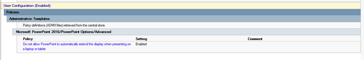

LeMarchand Posted January 16 Posted January 16 I use C:\Windows\System32\DisplaySwitch.exe /clone As a Startup Script along with Not sure if this works 100%, but I rarely have to Win+P. I should probably update my Office ADMX.
DrBeaker Posted January 16 Posted January 16 4 hours ago, LeMarchand said: I use C:\Windows\System32\DisplaySwitch.exe /clone As a Startup Script along with Not sure if this works 100%, but I rarely have to Win+P. I should probably update my Office ADMX. Does this work with Windows 11?
