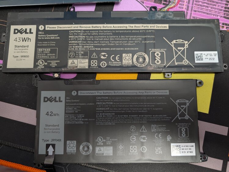

Top battery  - Pulled from a 2015 Dell Chromebook 11   - Cycles 394, battery health 87.18%  - lost capacity 502 mAh
Bottom battery - Pulled from a 2020 Dell 3100 - Cycles 67, battery health 11.38% unknow lost capacity

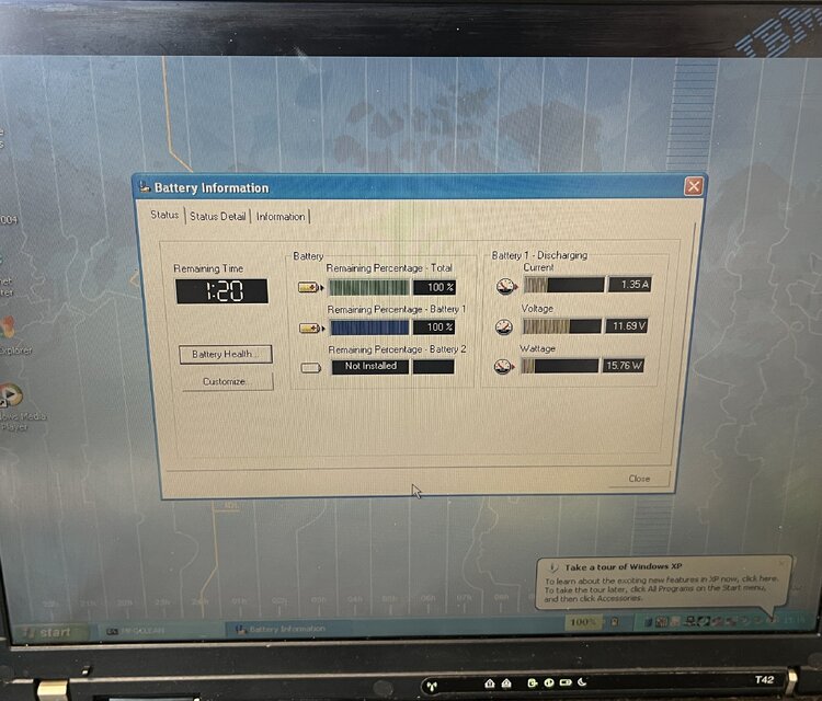

On my retro computing workbench at home I have a 22 year old laptop (with the original battery) that still charges to 100% and gives over 1 hour and 20 minutes of battery time which is what they would have roughly had back then!  It looks like it was used by a council (load of documents on it before I ran Active KillDisk on it and then did a full factory restore!
