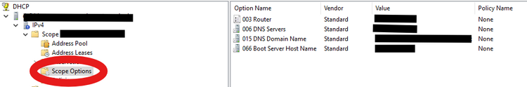

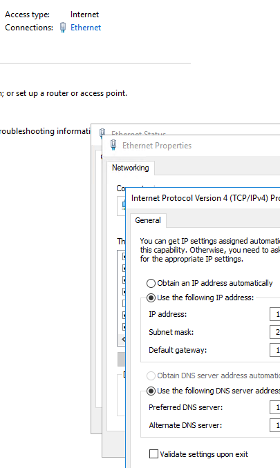

This thread kept popping up on Google last night when I was searching for a solution, so I thought I'd update with what cured it.
  1. As @psydii said above, pre-shorten the leases
  2. Set the TCP/IP properties on the DHCP server manually
  3. My biggest error: Set the scope options! You will probably have to edit options 003, 006 and 066 (if you use PXE boot). In my case I had to create 003.
After that it was fairly plain sailing.

From my other school that needed the same job doing:
Step 2: The DNS addresses are for the domain DNS server/s (possibly th same one you're setting things on) and not any ISP mandated forwarder. Oops!
