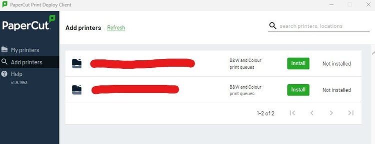

@CyBeRkId2002 We only have one print deploy zone, as it was crazy money to purchase more. We deploy the two Find-Me print queues to all users, setting the B&W print queue as the default. Other network printers we set as optional printers, please see attached image. We set permissions on both the print server and PaperCut for these optional printers, so only the desired staff can print to those. If anyone else tries to add them they get an error message.
