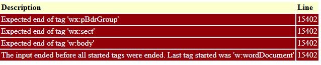

I have been asked to look at a SIMS XML report that is broken! I have opened the SIMS report in Dreamweaver and have validated the XML file and according to DW there are some 'expected end of tags'! I have checked the lines where apparently the closing tags are missing as highlighted by DW but the relevant closing tags seem to be there?? I am not that familiar with broken SIMS reports and wondered if anyone can shed some light as the closing tags are there?? The opening and closing tags are in the same case. It's driving me nuts as I have looked at the XML file so many times and I can't see any missing 'ending' tags!!! 🤪
This is the output from Dreamweaver

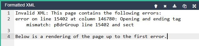

I also pasted the report into an online XML validator and this was the output.
