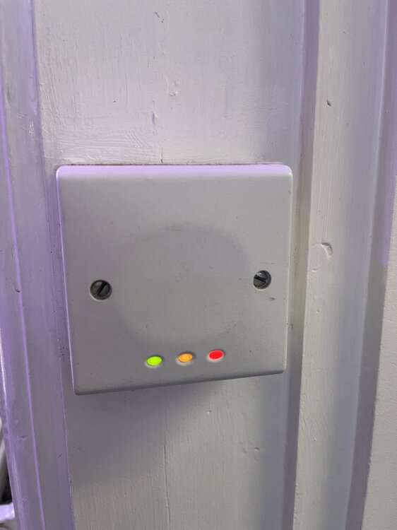

Had a power cut today and after the dust had settled we found one of the door card readers was not reading Net2 cards.
The reader LEDs are on and it bleeps when presenting a card but it doesn’t open the door and the event log for the door doesn’t show any cards were read. The door opens fine from the Net2 software so could the reader be faulty?
I’ve powered the reader off and on but it still doesn’t recognise any cards however, the reader looks old and not like any reader I’ve seen before.

I've not seen a Net2 reader like this before.
I was also going to say this, it looks like one of the ones from the old switch2 controllers, which aren't compatible with net2.  Post implies it previously worked before the power cut though?

I've had to reinstate the reader 3 more times today as it keeps failing. It runs fine for an hour or two then stops working so I'm starting to think the power cut somehow damaged it.
Does sound like it might be knackered, but worth swapping it to reader 2 port on the controller (and setting this up in the software) if you only have 1 reader and just a release button the other side.
