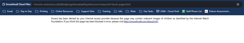

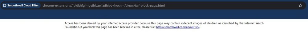

We're getting a brand new issue we've never had before where Smoothwall Cloud Filter is giving us this message when users are trying to print from SIMS:
I've had two reports of this so far this morning from staff - One from our Cover Manager, who is trying to print the Notice Board Summary in the Cover Arrangements tab. We've discovered that SIMS exports this as a HTML file in temporary files and then tries to open it in the default app for HTML files, which is Google Chrome. Even though this particular file is all text and no photos, Smoothwall Cloud Filter then blocks it with the above message.
A workaround is to set the default app for HTML files as Microsoft Word so that SIMS opens the file in Word instead, but this obviously isn't the most ideal solution. It looks like Smoothwall Cloud Filter is having some issues this morning, according to the Smoothwall Status page, and I can't access the Cloud Filter settings right now. I just wanted to check if anyone else currently has, or has ever had this issue and what you did to fix it please?
