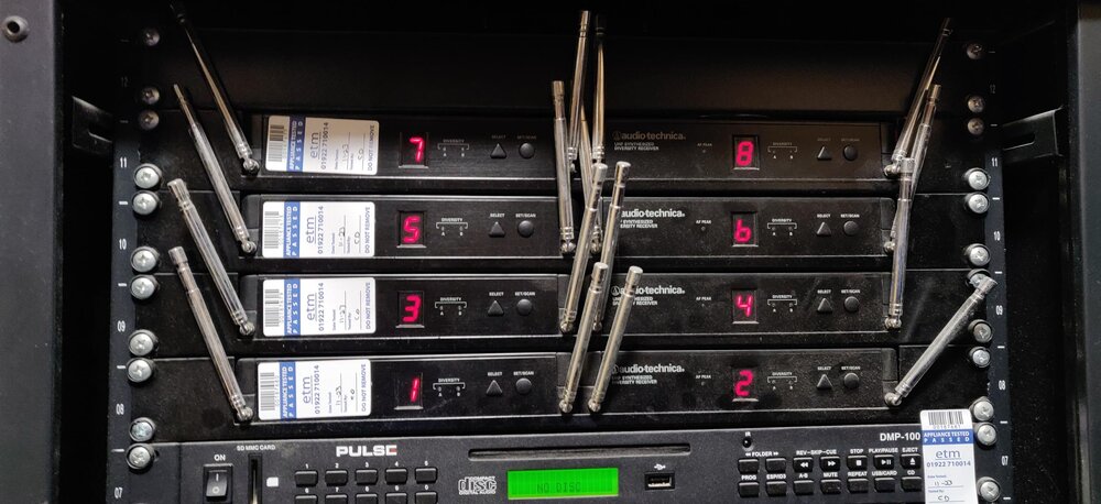

Looking to replace our dated 8 channel Wireless Microphones (image) as they are giving all manner of feedback on most channels due to what i think are issues on the receivers etc. i believe that the ones we currently have are an old technology too.
Issues i'm having is finding a solution that has the antenna on the front, most are now on the back. I've also contacted the likes of gear2music, managed service and also other companies for quotes, but most aren't very much help.

We've worked with plenty of wireless systems, but the only ones we've found to be solid are Sennheiser or Sure. Both of which aren't cheap, even second hand G3 units still hold their value pretty well.
The antenna connections are usually on the back, but when they're put in cases there's usually a cable that brings the antenna to the front mounted on a 1U blank.
My Sennheisers have leads out the back to allow extending your antennas, although mine go to a proper fixed antenna on the wall in the Hall
I'm an audio tech on touring music and theatre, outside of IT.
It isn't going to be cheap, but a proper wireless rack will be your way forward here. As mentioned in the previous reply, the antenna connections for any decent system are going to be on the back, but can be brought to the front with a rack panel. I would also suggest, if you go for something decent, you purchase a proper 'paddle' antenna, a splitter, and just have the one.
Personally, dependant on budget of course, Sennheiser's EW-D is the best bang for buck atm. Its digital, so does depend how busy your wifi etc is, but in general they're excellent. If you're looking to buy a ready to go rack, Mercury AV is a good place to start, but likely won't be the cheapest you can find.
The other option is to enquire with local hire companies, many will be refreshing old G3 stock to G4 or axient. They might be willing to sell a whole rack with all the bits needed.
I will say, that feedback is not caused by the Mic's. Feedback is a use issue, and even with the worlds best RF equipment, you'll get feedback. Feedback is caused by the mic picking up its own signal from the PA. That won't change no matter what mic you have.
Happy to offer advice on this one, its my wheelhouse

You may have to replace them anyway as most of the older wireless mics as I understand it, are actually illegal as they operate on the wrong frequency's nowadays - I am not an expert but I do remember a load of kerfuffle about it a few years ago. Consult an expert to be sure as the last thing you want to do is save money by not replacing them only to get fined for more than the cost of new sure ones??
Correct.
You can typically get 4 mics in the unlicensed channel 70 range (863.100-864.900).
For 8 in a primary school you will probably be looking at a channel 38 shared license (606.500 - 613.500) - which gives you up to about 12 mics depending on brand and spec.
If you're next door to someone else using the shared license you may need to go coordinated which prevents anyone else (legally) using your frequencies. We have 8 in Ch30 (542-550), plus 12 in Ch38.

It would be worth checking what frequency your current mics are on, as a number of years ago one band was removed from service. It might be that someone else is using that channel.
If you use one of the licensed channels then you get more mics simultaneously and less interference.
If you are getting proper feedback, then I would recommend checking any EQ settings on your sound desk or system controller (if present). If someone's boosted one of the frequencies that could cause this. You could also look up ringing out a sound system that might help set up your EQ to minimise feedback. Speaker and mic positioning are also really important for this.

This is probably the most important question. Before you spend any money, can you describe the actual issue you're having? It might be that we can help fix that. Do you use headsets, or handhelds?

The current equipment has got to be at least 10 years old and the transmitters antenna are bent, broken etc. So much so that if i were to hold the antenna with my fingers while being used the feedback stops. I think they just need replacing with a more current setup. We use headsets for out end of year performance with anything up to 8x 10/11 year olds singing etc. I know we can get really technical with setups and the equipment can be whatever depending on what you want to spend, but we just want to get to the position where we can use the mics for what they are intended for and mic up the children during the performance.

Just to add a few thoughts on everything already mentioned.
That many antenna bunched into a small space will more than likely cause issues. You've not extended them to their full length which doesn't help either. Antenna distribution will help massively.
From your reports it sounds like you may be using unlicensed frequencies caused by the changes in the frequency spectrum. Have a look at Ofcoms PMSE section (Program Making and Special Events) which covers microphone use for the letter of the law.
As others have said the free to use band Channel 70 covers 863 - 865 MHz. You can fit 4 frequencies on there comfortably, but it's a free for all. Channel 38 is the standard UK General paid for license and covers 606 - 614 MHz, but also gives you access to the "duplex gap" of 823 - 832 MHz. This isn't well known and not often mentioned as Channel 38 kit generally can't tune that high, but Channel 70 kit can go down to it. Worth looking at is it is often free. The final alternative for RF is using the "interleaved spectrum" which is the gaps between the TV stations, and is a location specific license agreed with Ofcom. We have 3 interleaved licenses, but these are on frequencies normal UK kit can't tune to so getting hold of the kit is a little more difficult. I've found this chart from Shure is really useful for visualising all of this.
In addition you have digital microphones such as Sennheiser EW-D, some work in the 1.9 GHz range (DECT frequencies), others in 2.4. Research before committing to a purchase!
Expect the Sennheiser G3/G4 secondhand market to be flooded soon as it goes end of life at the end of the year and companies will be making the jump to EW-DX. 8 systems with 2 ASA units (antenna splitters) and remote antennas might cost a few thousand now, but will last you a good while yet.

One thing i will say, is I would stop using the word 'feedback' to describe your issue. It doesn't sound like the issue you're having is feedback.
