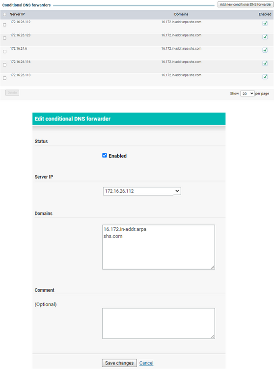

timbo343 Posted October 19, 2023 Report Posted October 19, 2023 We have our DNS set up like this: Windows DNS (under Forwarders tab) points to the Smoothwall and to other DNS hosts, with Smoothwall being at the top of the list. Then on the Smoothwall DNS page: Use System Internal DNS Server DNS forwarders: 8.8.8.8 | All available Conditional Forwarders: Server IP - you DNS servers Domains. The "in-addr.arpa" addresses from your windows DNS and your local Domain suffix.
timbo343 Posted October 19, 2023 Report Posted October 19, 2023 (edited) [ATTACH=CONFIG]70126[/ATTACH] domain has our internal domain there but hidden it Change your conditional DNS forwarders. Here is an example: Also as a test set the User Defined option on the DNS page to one of your windows DNS servers, just for testing at the moment. Edited October 19, 2023 by timbo343
DGardiner Posted October 19, 2023 Report Posted October 19, 2023 presumably thats your ISP dns, bin it and fire it all at google, may need to reboot to unupset whatevers broken
