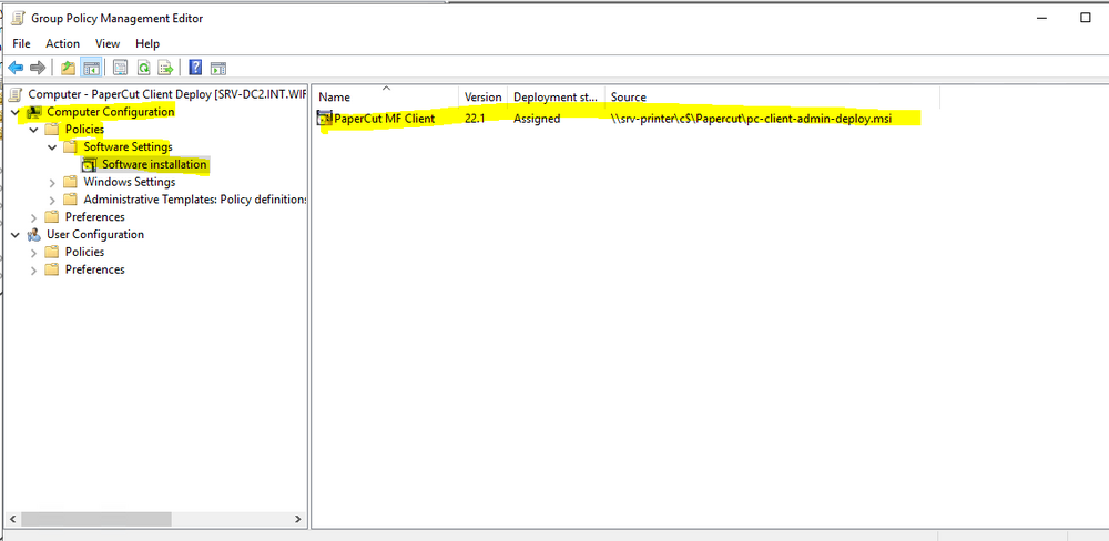

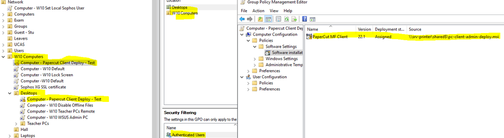

leewakelam Posted August 23, 2023 Posted August 23, 2023 Can anyone please help?? How to deploy the client on all PC's around the school from the print server? I thought the best way would be via GPO - computer configuration, policies, software settings, software installation. Then add the MSI from the print server but nothing happens on any pc around the school
tosh74 Posted August 23, 2023 Posted August 23, 2023 Copy the MSI where the machine accounts can access it or create a new shared folder under the PaperCut folder and place the MSI in there and update your GPO to point to new location of the MSI. C$ is an admin share and can only be accessed with admin credentials

leewakelam Posted August 23, 2023 Author Posted August 23, 2023 I created a folder on the printer server desktop and shared that. Unfortunately still didn't work

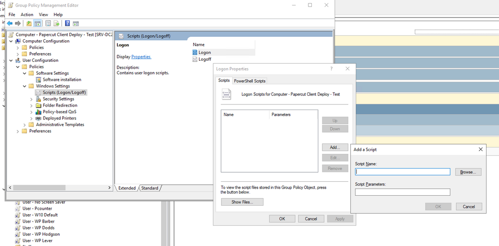

leewakelam Posted August 23, 2023 Author Posted August 23, 2023 That does work but get the error message, do you know how to get rid of this? Also when i go to add a script it wants a file so how do you add the script? thanks again
altecsole Posted August 23, 2023 Posted August 23, 2023 That does work but get the error message, do you know how to get rid of this? Also when i go to add a script it wants a file so how [ATTACH=CONFIG]69725[/ATTACH]do you add the script? thanks again [ATTACH=CONFIG]69724[/ATTACH] For the C:\Cache folder, we have a PowerShell startup script that sets the folder permissions. It removes, and recreates, at each startup, as the Cache folder can sometime get corrupted (apparently). We log to a local file, which can be useful. Here is the bit of code we use for the Cache folder: Start-Transcript -Path "C:\Windows\temp\compstartup.txt" $cachePath = "C:\Cache" if (Test-Path -Path $cachePath) { Write-Host "Cache folder exists. Going for remove, new" try { Remove-Item -Path $cachePath -Force -Recurse New-Item -Path $cachePath -Type Directory if (Test-Path -Path $cachePath) { write-host "Setting permission on Cache folder" try { $acl = Get-Acl -Path $cachePath $rule = New-Object System.Security.AccessControl.FileSystemAccessRule("Users", "FullControl", "ContainerInherit,ObjectInherit", "None", "Allow") $acl.SetAccessRule($rule) Set-Acl -Path $cachePath $acl } catch { Write-Host "Unable to set folder permission for " $cachePath } } } catch { Write-Host "Could not remove folder" } }
