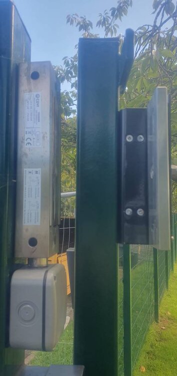

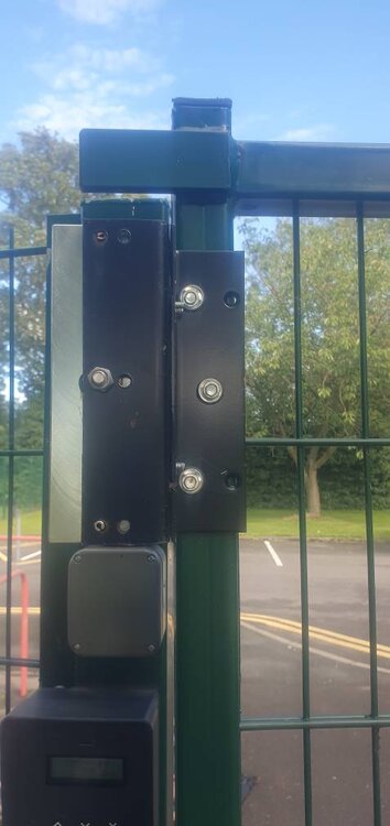

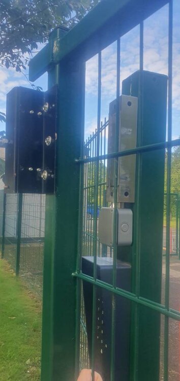

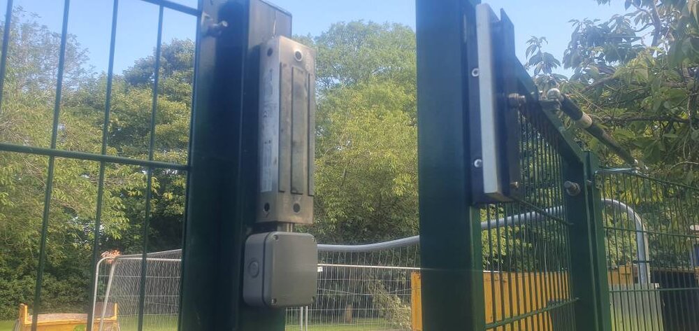

newpersn Posted August 5, 2023 Report Posted August 5, 2023 On this note We are installing Access Control on a external gate. What's the best fittings to use? Metal gate, I might add.
