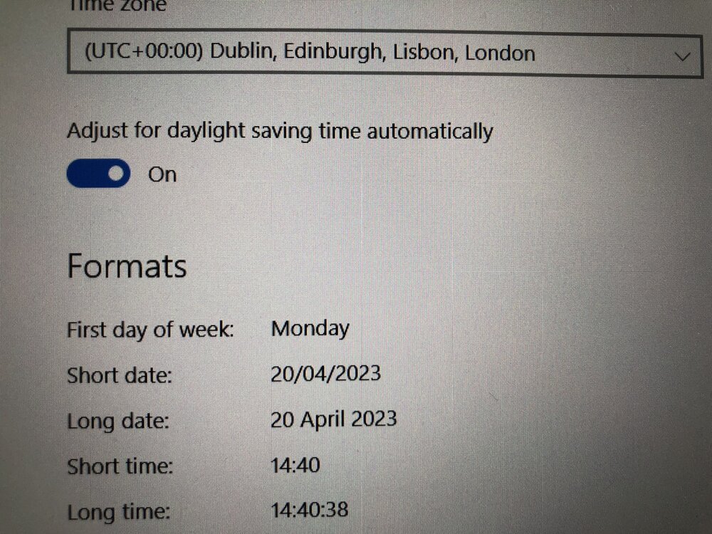

See attached, right now time correct. As soon as I turn of this option, 1hr behind.
My understanding is NTP sever get time from external source so this option should be turned off.IMG_8129.JPG
Ours is on.
I thought as much but see below for confirmation (first internet search came up with this):
"Because NTP is based on UTC which does not have a daylight savings time period, a switchover is not necessary inside the NTP system. The operation systems of servers and clients are solely responsible for switching from/to DST."
https://www.meinbergglobal.com/english/faq/faq_33.htm#:~:text=Because%20NTP%20is%20based%20on,for%20switching%20from%2Fto%20DST.
EDIT: Link is provided purely as credit, not an invitation/advertisement/recommendation to visit...
Edited by Koldov
So my settings are correct?
Yes.
NTP (advertises UTC) > DC (converts to DST) > CLIENT
Although it might be a little more complicated than that... for instance all my clients have 'Adjust for daylight saving time automatically' set, but these don't take/add the extra hour from the time the DC is advertising... something clever to do with the fact that the server knows it is getting UTC (Type: NTP (Local)) time and the clients know it is getting DST (Type: NT5DS (Local)) - basically whatever the DC tells it the time is (which might negate the other settings on the client I've never tested it)...

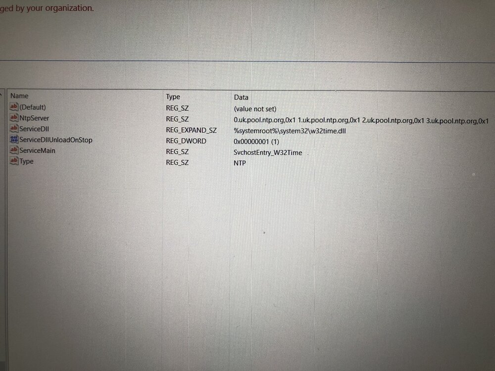

What’s the difference between;
0.uk.pool.NTP.org,0x1
And
0.uk.pool.NTP.org
I think these are to do with 'poll intervals' (or how often it requests an update) but there are other flags that deal with how it treats each server you've specified - as a main, fallback, etc.
"Each time source may also be followed by a comma and a DWORD containing flags for special handling of that time source"
