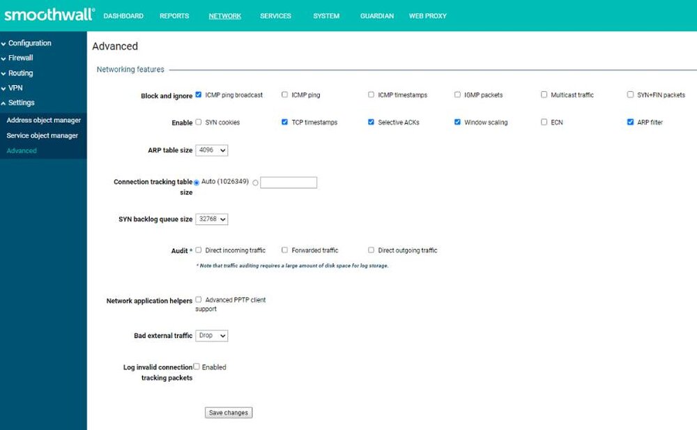

timbo343 Posted March 13, 2023 Report Posted March 13, 2023 @ssouth thinks his has been resolved. He asked me to double check my settings in this page 1
timbo343 Posted March 13, 2023 Report Posted March 13, 2023 How do you get to this page pleaseNetwork > Settings > Advanced
Pjchadwick Posted March 13, 2023 Report Posted March 13, 2023 Mine matched your settings apart from ICMP time stamps was checked to block and ignore
ibpalle Posted March 14, 2023 Report Posted March 14, 2023 Any reason the ARP filter setting is enabled?
timbo343 Posted March 14, 2023 Report Posted March 14, 2023 Any reason the ARP filter setting is enabled?Nope, i've never changed these settings myself. Should it be set to Enabled?
ibpalle Posted March 14, 2023 Report Posted March 14, 2023 The ARP filter setting should only really be enabled in case you have multiple interfaces configured with IPs on the same subnet (Not multiple IPs on the same interface)
