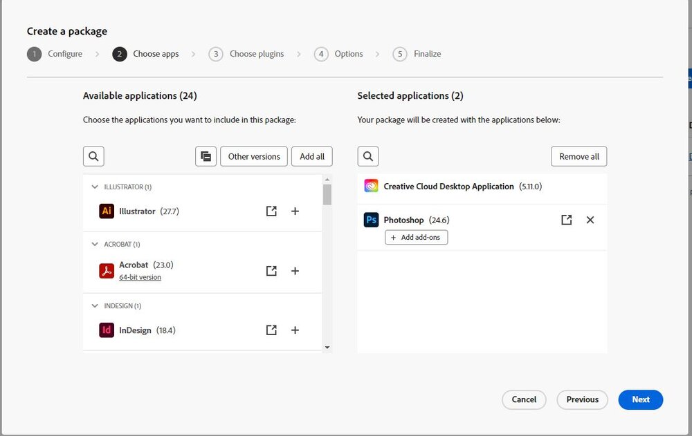

If your deployed package hangs, try removing XD and allow users to install that themselves. Caused no-end of issues trying to build it into a package.

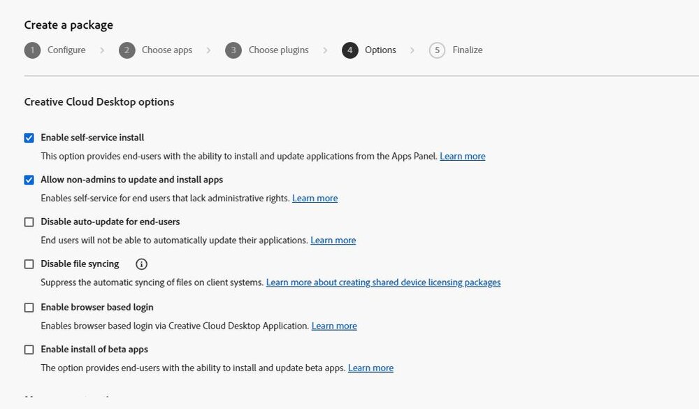

Creative Cloud Desktop optionsEnable self-service install - tickedAllow non-admins to update and install apps - tickedDisable auto-update for end-users - not tickedDisable file syncing - not tickedEnable browser based login - tickedEnable install of beta apps - not ticked

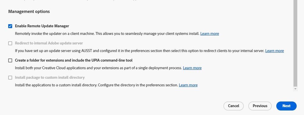

Management options
Enable Remote Update Manager - not ticked
Redirect to internal Adobe update server - based on above option, so nope.
My users can install and uninstall different programs within the cloud app without admin rights, they can update if they wish. I was advised against setting up the remote update manager as it was "a ballache". Then again a year ago I wasn't in a position to play around with it, I needed to get it deployed asap.
Remote updater works but is limited to updating with in the current version so won’t migrate installs to the latest main release
Management options

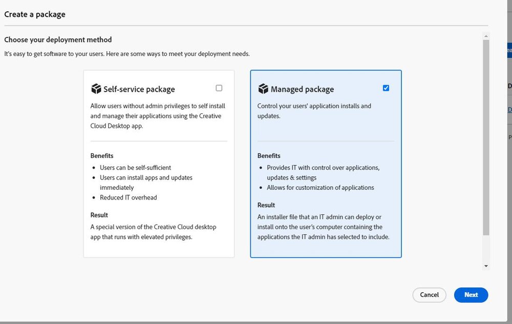

In the package creator you can specify a list of apps to deploy (one installer that initialises once and installs the list.) or self service, different use cases - we have a set list of CC apps to deploy to suites and certain teaching PC's and then self service on staff laptops to avoid bloat.

finding it confusing that I'm choosing Managed Package, but then later in the options it's giving options to allow users to install themselves!
