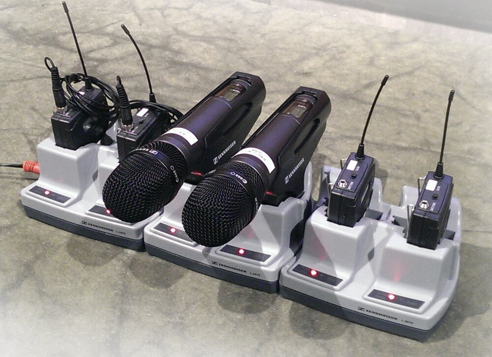

Across the board we use Sennheiser UHF systems, with charging cradles and rechargeable batteries. A bit more expensive to start with, but means no-one messing around changing batteries as they can stay in the mics while charging, gives them somewhere to live and means the mics are always ready for use. Something like this -
