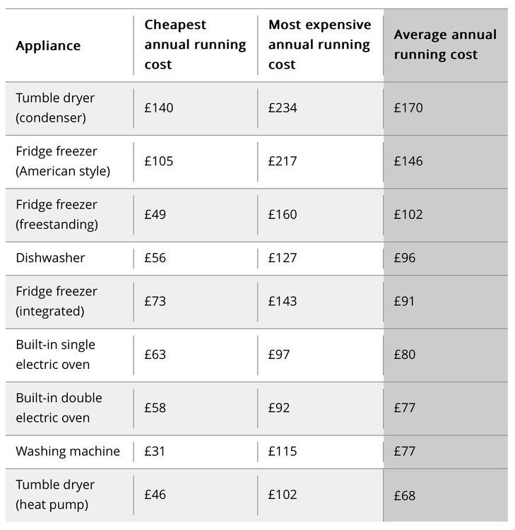

Article on the Which? website contained this table of most expensive appliances to run
The full article including energy saving tips may be behind their paywall.
They do say descale your kettle, defrost your freezer, stack your dishwasher so that it’s completely full before you use it and dry your laundry on racks or outdoors if possible.
https://www.which.co.uk/news/article/find-out-how-much-your-household-appliances-cost-to-run-aP1BZ7f2GNYd
Edited by elsiegee40
  • Thanks 4
[ATTACH]67183[/ATTACH]
Assuming it's in the print issue, check your local library for a copy.
Were people not doing all those things and just wasting money for the past 30 years then?
More top tips: Don't leave things on that you're not using, shut doors, use the free sun.
