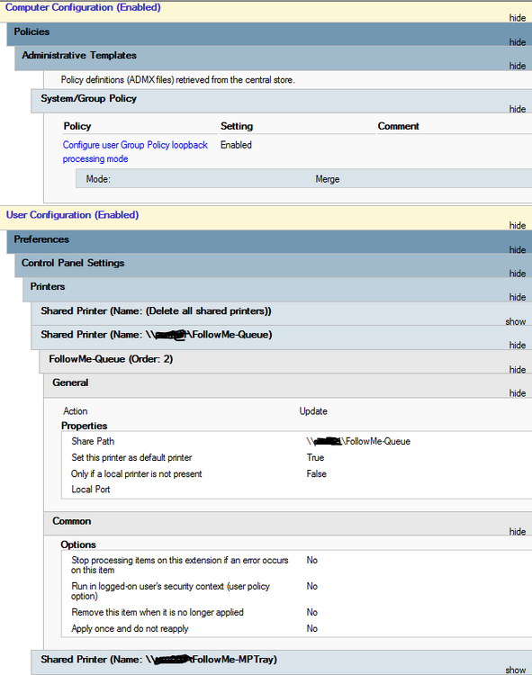

I can see that you are doing it as "User Configuration", but is this linked to a Computer OU, or a User OU? I'd like (for example) the room 20 printer to be the default printer when they are in room 20, the room 15 printer to be the default when in room 15, etc.

The method above is using Loopback processing (User-level GPO's applying on a computer level). As that deployment is using the "FollowMe" setup (aka jobs sent to print queue to be released off any printer of users' choosing) - this method works fine.
In your case, you may have some luck with Item-Level Targeting etc to map printers. I may be missing something; but in yesteryears I always used something direct within Group Policy to map printers and never had any problems.
That's correct, thanks.
While this one is the for the follow me, it works just as well installing individual printers based on computer/location. As in if a PC is in an office with a private desk printer, then the desk printer is mapped (as well as the follow-me) and set as default. (We've set up different OUs for each room that has access to a local printer).
We do it with a policy linked to a user OU - it was really unreliable on a computer OU. Then GPP with item level targeting picking out the printer depending on the name of the PC.
I've been using loopback processing mode too.

This is how I do it.
Create a user GPP policy
Do not check run in logged on user context. This will allow it to process as the computer. So far this has avoided the admin prompts for me.
Under ITL set rules for the computer to belong to a specific OU, Security group or netbios name. There is two options on the OU and group rules. User belongs to or computer belongs to. In this case you want computer.
When it is the follow me queue or a lab, it is easy to target the OU.
If it is a shared office printer, I put the users and computers in a group called print-queuename
This serves two purposes, one gives a group to target for deployment and two security of who can access the printer. Weather that is windows built in permissions or via papercut.
Finally for a one off single office and / or the teacher laptop for a lab. Netbios name. Although I think I got rid of most during a clean up this summer.
I had a single user printer user change for this school year. I took the time to remove the netbios name and just create a security group. It only has one computer and one user in it, but if the new person doesn’t stay, I’ve got one place to change it.
The problem with netbios names is you have to update the GPO when the user or computer changes vs just adding to a security group.
Also if you rename the computer for whatever reason, the name in a security group is automatically updated, GPP not so.
