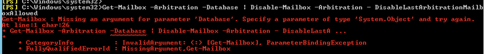

Thank you, I'm trying to do it properly and once I tried to uninstall Exchange it gave me a bunch of errors and won't successfully uninstall. As a result I followed this guide on Spiceworks https://community.spiceworks.com/how_to/165831-how-to-decommission-exchange-server-after-migration but when running the Powershell commands in Step 2 the server just tells me there's no existing command.
Any ideas?

Thank you for being so kind and offering to help, I've been working on this all day and still can't get it to uninstall. Tried everything I can find online and nothing will work. It's Exchange 2013.
When I run the command shown in the Spiceworks documentation it just comes back with the following error.
[ATTACH=CONFIG]62664[/ATTACH]
You need to put in the database name after that switch. You can find this from ECP - or via Get-MailboxDatabase in PS.
