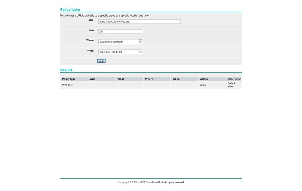

Thanks. Really odd. It says it's on the "default allow" list here, and when I check what's been blocked for me it's not there. Guessing it is blocked higher up the chain. I'll have to let the owner know as (whilst adult films are listed if you make that choice) it's basically a less corporate version of IMDb (which, IIRC, shows adult movies by default).
Use the policy tester in Guardian - quick links to test and see what policy blocks it. Or have a look at the realtime logs and filter for the URL - the policy that blocks it should also show.
Tried the first - says it's on default allow. Will try t'other on Monday, but I looked to see if I had been to any blocked sites and there weren't any.

The default allow means that there are no policies that apply to it - were there any HTTPS inspection policies listed when you try the policy test tool?
Our Smoothwall comes via the LEA, so I'm not sure it's "vanilla".
If I run the tester on the URL I get:
Ran an audit trail on myself and TMDb is showing as an Adult Site, as @Tammie said.
Any way to get this corrected, @ibpalle?
Most likely blocked due to the adult sites, which is a global policy and thus cannot be overridden by the policies local to your location. Either adult sites have to be unblocked globally and then implemented locally for each location(tenant) or the domain has to be allowed in a global custom allow.
Not being quite aware of how the filtering is setup in your situation but the name of the category group that Adult content is part of is called Global Forced blocked categories so yes, I would assume so.
