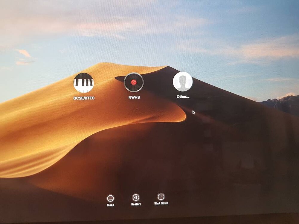

I am not seeing any circles, red or green but that could be down to how we have our login set up See screenshot
