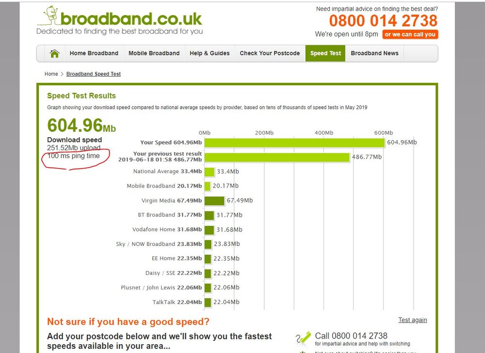

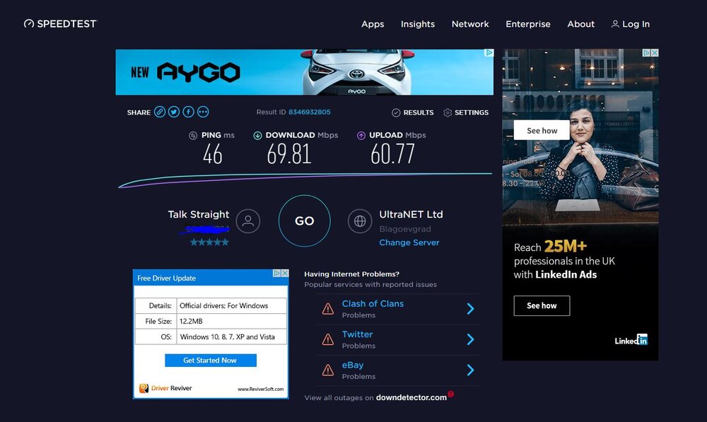

Just testing by moving a few of my PCs into Schools Broadband cloud router and re-pointing the gateway, little faster but same issues (with latency errors, and ones that can run the test are giving very varied performance (we have a 1Gb lease line from you) ping one.JPG

Please use our own speedtest.net server (Talk Straight Ilkley) to do some speed testing with as that'll give the most reliable results although we can also do iperf tests as well but I'd need to get an engineer to talk through that with you also.
